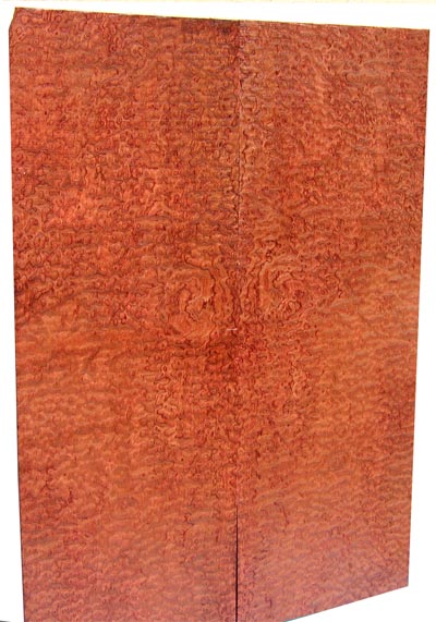

I just received a set of some of that intensely figured quilted bubinga we've probably all seen. The sides arrived broken, snapped right in the middle. Looking at the break, as well as looking at the grain on the edge of the boards, I can see that the grain zig-zags extremely -- much moreso than your average curly-figured wood (I've just looked at the edges of several sets of various curly woods I have in my stock to compare). It's no wonder that the sides snapped, with the grain running nearly perpendicular to the surface in many places. It makes me think it must be extremely difficult to bend this wood without breaking it. Have any of you used this stuff and found that to be the case? Or have you found that it actually bends reasonably readily? Your input would be helpful to me in deciding whether I want to order a replacement set or just get my money back.
I'd also be interested in hearing any observations about the sound of guitars built with this stuff. It's amazingly beautiful, but with what seems to be virtually no longitudinal grain integrity, I wonder if it can make a good sounding guitar. The tap tone sure isn't much to speak of.

Are you talking about this stuff - I have that set and I'm a little afraid of it.

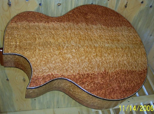

I just finished an OLF-SJ made from Waterfall Bubinga from the Zootman. It is the most hypnotic wood I've ever seen. Tap tone was decent and the resonance, tone and volume of the finished instrument sounds better than anything I've made to date.
I was expecting to have a difficult time bending the sides but was pleasantly surprised at how well it went. One area that requires a LOT of attention is sanding and scraping the sides level after bending. Because of the extremely high figure, it gets lots of peaks and valleys that need to be flattened before binding and finishing. I can't begin to tell you the number of hours I spent getting it smooth.

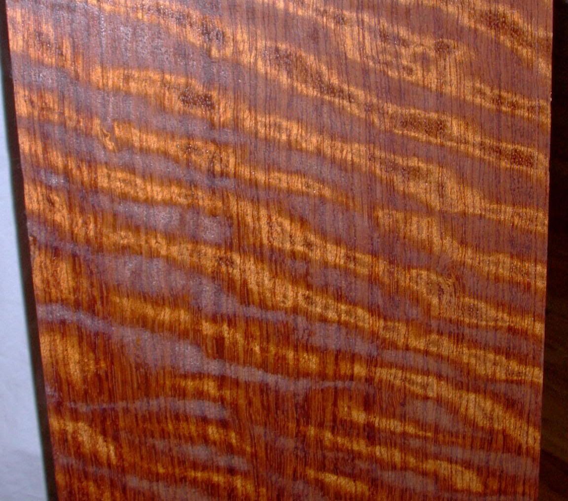

Trevor Kronbauer's building a guitar for a client of mine with some of the crazy stuff. Bending went okay but there was one spot where the quilt didn't want to bend along with the sides and split off. I believe he was able to coax it into position and glue it...hopefully there will be no long-term issues with the wood. Certainly is striking!

This picture from LMI is probably more like what Todd is refering to...:
The waterfall stuff is reasonably stable. Several people have built with it with fine results.

The stuff that Andrew shows in his post looks almost exactly like what I got.

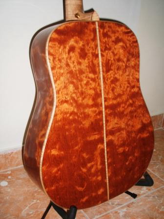

This is a 12-string built with bubinga from LMI, bearclaw sitka top, and maple neck. It is difficult to compare because I don't have my Gibson 12 around. It sounds a little "tight" right now but I expect it will "open up" with more play. I have only had it a month. 12 strings are always difficult for me to compare with 6 strings because they have so many high note strings.
My friend said bending the sides was difficult and comared it to some quilted maple he did for me.
